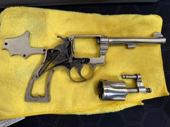

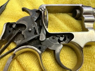

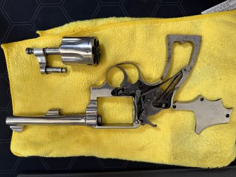

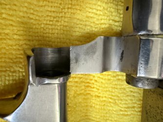

Good afternoon, I have never posted on any forum but I am really stuck on trying to figure out how to identify/age/clean/disassemble this revolver.
There is no serial number on the yoke, only the assembly number.
1. It is a Hand Ejector
2. Serial Number: 41025
3. Caliber: 38 S&W Special U.S. Service CTG
4. Barrel Length: 5 inches
5. Sights: Fixed
Extra:
No strain screw, No butt swivel, No lanyard ring
5 screws

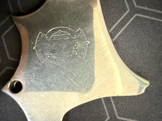

There is also seems to be Spanish patents on the top of the barrel (see picture)
Thank you for any and all help you can give me!

I did some digging and it looks like you are right. first revolver I ever purchased and I got the Spanish knock off lol
Welcome to the Forum.
It is not a S&W nor is it an N frame. Looks more like a Spanish copy with a Colt-like main spring.
Looks like it says "Eibar" on the barrel.
Thank you for the quick response!
This link looks almost exactly like mine.
I concur on its being a Spanish copy. I think it's specifically an Orbea Hermanos.
O.P.s revolver is a Spanish knock-off of a S&W K-Frame .38. Specifically is was made by Orbea Hermanos (Brothers) in Eibar, Spain. Probably dates to 1920-1930's.
The lockwork is Pieper type, typically used by both the Spanish and Belgian makers of revolvers. It is similar to Colt, but not really the same.
