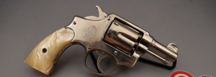

Would an "N" stamped on the cylinder crane indicate factory or perhaps refinished in Nickel? I've had one person suggest my hand ejector was a cut down originally blue but I don't see it.
Hand ejector/Square butt currently wearing genuine mother of pearl stocks, but no markings on back. S/N under barrel, on cylinder, behind cylinder on crane 904773. Butt s/n first digit too worn to read but 04773 is clear on butt. No caliber markings anywhere but one observer noticed second depth ring apparent in cylinder. Cylinder is 1-9/16" long. May have been 38S&W bored to 38 special. Fires and unloads 38 special without a problem. Barrel length measured from front of cylinder is 2-1/2". Sights are fixed. 5 screw plus strain relief screw on front of gripstrap. Serrated trigger. Textured hammer. Large S&W logo on right cover plate. Made in USA in front above trigger on RH frame side. No other engraving other that assembly numbers on crane and frame. To me the nickel plating looks complete and original but I am not authority on such matters.
I just purchased the weapon from a FL FFL via GB. Described as Model 1905. What do you think I have? I'd gladly trade the pearl stocks for oem or replica walnut or black rubber.

Sorry, but there is nothing factory about that gun. Cut down barrel, buffed hard and plated. Probably started life as a British Service Revolver.
That's okay. You aren't the first to advise that. Luckily, I got it cheap and am enjoying it. Appreciate your input and I won't waste ordering a letter on it.
