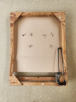

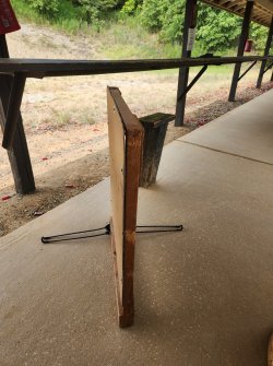

I've got a couple of simple target stands that I've used for about 40 years. Just a couple of wooden frames made from 2x2, with cardboard attached to the front to staple targets to. To stand them up, I always carried a couple of short boards and C-clamps to the range with me, and would clamp a board to the base to make a T shape.
It worked and was simple, but kind of a pain to have to remember to take the boards and clamps, and to take the time to put them together at the range. So last week I was thinking about folding tables and looked on Amazon for folding legs. There are a variety of types but lo and behold, I found something that would work perfectly: Foldable hairpin legs.
I bolted a couple on each side of my stands. They snap and latch open in a second, and close easily. As-bought the legs are at a bit of an angle to the bracket and would raise the stand off the ground a couple of inches, but it was easy to bend them a touch so that they sat flat. Tried them out today and now I'm ready for the next 40 years!

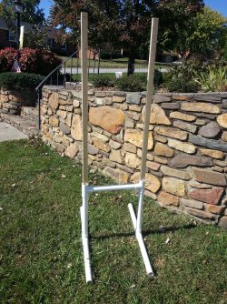

I made a 1-1/2" PVC pipe base out of nominally 2' long sections so the base is about 2'-4" wide x about 4' long. It doesn't blow over. It's held together will 4 elbows and 4 tees. I keep the works in a duffel bag. Goes together like Tinker Toys. Two 1" x 2" uprights about 6' tall with a piece of 1/4" sheet bolted to them with wing nuts.. Easy to replace.

^^^ same here. Found the pattern on line somewhere. I use staple gun to attach cardboard sheets to wooden uprights for attachment of targets. Use old camping folding chair bags to tote them in. I go to a couple of National Forest Ranges and they only allow paper targets and only have wire strung between posts at 25 and 50 yards to hang targets so I needed some portable stands. Works great, cheap to make, lightweight. If you enlarge the picture you can see one.IMG_1384.jpeg

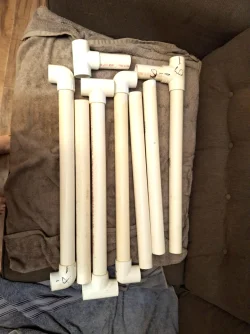

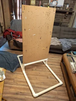

Better photos of the PVC pipe target frames. Easy breakdown and fits in an old folding chair carry bag. IMG_0415.jpegIMG_0414.jpeg

Oh, I didn't list the two 5" long pieces to connect the crossbar. And I bolt the panel on with four wing nuts so it's easy to break down or put on a new panel. If anything gets shot you just cut a 2' long piece or buy a new fitting. Last time I was out my shooting buddy had a rifle he bought and had bought a sight that wouldn't work, but he wanted to shoot the gun anyway. It was an AR type gun chambered in 7.62 x 39mm and he must have shot 100 rounds out of it. I think I salvaged a few of the fittings and a couple of long pieces had holes in them but could still be reused. The rest was junk. So I sawed up a 10' stick of PVC and bought some more fittings.
