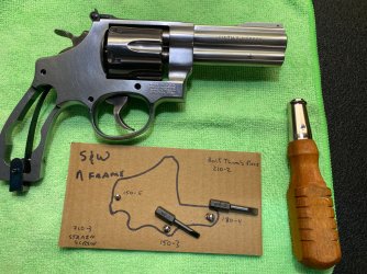

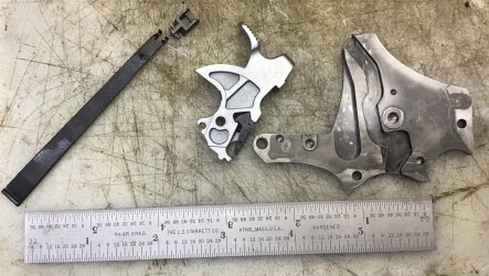

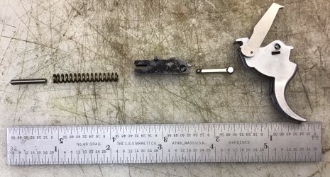

After cleaning the 610 decided to see what the action looks like, here it is. Quite different from older K,L and N frames. Mim parts except for the hammer safety block which was stamped as most others. Deburred parts and stoned transfer bar as usual and touched up sear with very fine stone with only 2 strokes. Polished hammer sear with fine cratex cleaned everything and back together. Action feels a little better and range trip tomorrow will tell. Comments welcomed.
