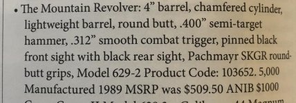

Here is what the gentleman sent me…. He claims under 1000 were done like this
That is indeed the Mountain Revolver. It came before the Mountain Gun. I've heard others say there were 1000 produced. They are much more common than that. According to S&W 4th edition 5000 were produced. One just sold on this forum last month. The Magna Porting was definitely done later. For what it's worth I have a Magna Ported 6" 629-2. It does reduce muzzle flip and felt recoil. But it's a bit louder if that matters to you.

Although I believe some Mountain Guns were Magnaported OEM via Magnaport, none of the 5000 -2 Mountain Revolvers were.
