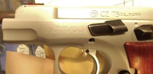

My LGS has this for sale and I've had it put on the shelf in my name. I'll be picking it up on the weekend.
But as I'm not terribly familiar with CZs (I just recently picked up a 75 SAO and liked it enough to want DA/SA) I thought I'd ask here.
From a quick peek at the internet I think I have a pre-B in stainless. Yes?
It's got FO front sight; a really sweet trigger breaking around 4 lbs. SA and probably no more than 6 in DA. One sided safety, and the pictures match other pre-B pics I've seen.
They are asking $450 but there may be a bit of wiggle room on price. Bore is good and it's clean.
I'm not wild about the grips but that's easily fixed.
Serial number is Z1756 and I'll be trying to look that up to see if it gives me a clue on date of manufacture.

This 75B is Z 60XX, a little more than 4K away and mid-'90's vintage. I think the pre-B models ended a bit before. The values continue to climb for all 75 models. Joe
It is a pre B. (no roll pin in the slide in cocking serrations is the give away.)
It isn't stainless. It has either been hard chromed or some type of cerakote.
The front sight has been replaced.
There is some kind of import mark I can't make out on the right side, something Houston TX.
I think $450 is high since so much as been done to it.
Grab it if you like it!!

Among other finishes they used on pre-Bs CZ sold bright chrome into the U.S. civilian market. However, that looks like a mate finish of some kind. There was a flood of inexpensive surplus blued pre-Bs on Gone Broker a while back. Refinish on one of them would not be a surprise. After you get it home it would be nice to see pictures without the glare.

So...here's what I think I've learned about this gun (which I will be buying.)
1994 Transitional (between original 75 and 75B). No firing pin block (so no roll pin on the cocking serrations). It ain't stainless. (I should have realized that, it isn't heavy enough ala a 5906). Probably either the polycoat was buffed off (unlikely) or some sort of silver polycoat which has been reported being used in Europe or some sort of Ceracote, but it doesn't feel like that to me. As it has a partial import roll mark "Houston TX" it's probably the European coating.
Made after Jan 1, 1993 as it says "Czech Republic" and as the front sight can be replaced (and was) that further confirms it's a transitional model.
Unfortunately it comes with just one mag. But apparently my 75 SA mags will fit as will current production mags.
So that's about it. More, better pictures when I pick it up on Friday.

The finish looks like their satin nickel. Hard to tell in the photo.

I'd say it is an Israeli surplus one that hit the market a few years ago. I searched around and the import mark is Interarms - Houston TX.
The missing first few letters of Interarms means it was buffed out once it got over here and refinished with most likely some type of spray on coating.

There's a couple different CZ forums, I think czfirearms.us is the biggest one. You can get a ton of info there, and there's usually a couple threads on refinishing older pre B's and transitional models (you have the transitional).
Square trigger guard and Czech Republic give that away.
Refinishing- A lot get refinished, because they're nice guns, and very well protected initially... they were parkerized, and then polycoated. Most beaters just have chips on the polycoat, the park underneath is light colored.
People strip the polycoat with airplane paint stripper, then beadblast the park away, and then either do a quick refinish, or polish down and blue them. There's one guy in particular, I forget his name, that has done quite a few rust-blued, and they're gorgeous.
