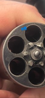

Appears the revolver went back to the factory for service in October 1954. Front sight indicates the barrel could be a replacement from that period and numbered by the factory. Grips are probably from a later M&P C series revolver. Cylinder could also be a replacement. My best guess is that the original revolver was one of the South African BSRs, and the frame was later fitted by S&W with a .38 Special barrel and cylinder. Extractor rod has knurled tip and is definitely post-1947. Any other guesses?

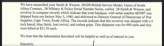

Any rate i'm going to pay the money and send in for the providence letter to the Smith and Wesson Historical foundation just to have the paperwork. I think that is so cool. I absolutely nerd out at old guns like this.

If you do order a letter, you might post it here just to close the circle. Interesting that a previous owner would go through the trouble to rebuild a BSR when he probably could have bought a nice condition used .38 Special M&P cheaper.
Interesting enough I did find some one that posted about a BSA revolver back in 2012 (which had not been altered) and per the Smith and Wesson letter some revolvers were bought back to be used as government surplus and converted post war to the more popular .38 special.
Now I know we can beat this to death but I’m hoping that this gun was one of them. It would be really cool. Either way I will send off my stuff this Tuesday and when the letter comes back I will tag this post. Thank you again.
