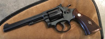

Here’s one. Very sweet shooter! It’s everything I expected and more. Now I’d like a K38.
Thanks for the info. It really doesn’t matter to me since I’m not a collector. I just wanted a nice example to shoot.
