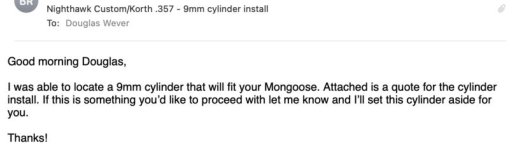

Anyway, I had an e-mail saying they finally tracked down a 9mm cylinder they can hand-fit to my .357, and I'll have the weapon back in 5 to 6 weeks. Thanks! Peace. (picture of Korth Mongoose with 9mm extra cylinder is not mine).
