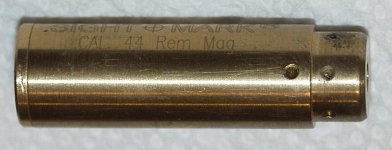

At indoor ranges I lay my 44 caliber laser bore-sighting cartridge on the notch and adjust the tripod so the dot is on the target.
Very easy to recheck every once and awhile.

If I hadn't re-purposed the little laser cartridge I already had and wasn't using much,
I would have gone with a similar setup after looking at the options.
