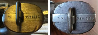

Since we consistently see the flaming bomb on the butt of both DSC and Maritime Commission guns, the contracts between Navy and Army aren't the whole story.
Keep in mind all this stamping was done at the factory by ordnance contract employees, not by military personnel from the various branches.
It's the same issue with the triple-P proof, which was supposedly a military proof, but almost all DSC Victorys shipped 1944/45 have those.
At Colt, it's even less clear; I have a Commando from 1943 with both G.H.D. and flaming bomb which shipped on a DSC order to a defense contractor.
Attached:
V 121432 Maritime Commission Contract shipped 4/27/43
V 626880 DSC Contract shipped 6/6/45
Attached:
Abs, thanks for the pics.
One thing that stands out to me, when viewing your pics, is that whether or not the "V" was on the same side as the serial number on the butt was possibly determined by whether or not the serial number had a several wider numbers versus more narrower ones.
Then again, the separated "V" is on your later example as well, so maybe S&W simply started doing this at a certain point in production and stuck with it 'till the end?
Dale
