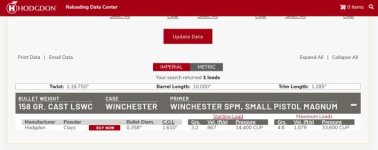

Hodgdons indeed has a Clays load using a 158gr LSWC and 3.2gr (@ 867 fps) to 4.6gr (@ 1,079 fps) with a normal (for 357 Magnum) OAL of 1.610".
No need to load short, unusual need to scrub, etc. Plenty of room to experiment quite inexpensively.

Whooop there it is!
Reloading Data Center | Hodgdon

Looks like Hogdon says this is ok.
