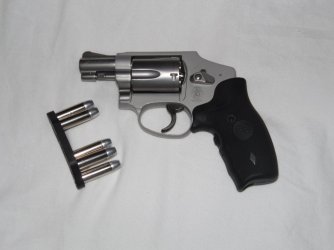

Well, after months of wait, I picked up my brand new 432uc last week from my dealer. I drive to the range today, and figured I'd get some practice in.
Loaded it up with 6 rounds of magtech 32 S&W long sjhp, pulled trigger 6 times, no bang. Tried again through the whole cylinder, and 2 went off. I switched to 32 H&R Federal 85 grain personal defence jhp, same issues, same with Hornady critical defence 32 H&R :) I pulled the trigger likly 40 times to get a dozen to ignite. Revolver guy next to me looked at it, says firing pin barely sticking out. Attaching a picture to show how barely any mark from the firing pin.
So now to send it back.

Here we are about a year later and guess what! I bought a new 432UC in April, took it to the range, and had the same issues as everyone else, and more. Frequent light primer strikes, and the trigger bound up and required two fingers to pull it back after two or three shots.
I sent it back, and received a notice it had been logged in a week after FedEx said they delivered it. I have a couple of weeks more waiting to do. I love my M&P 340, but as it was getting a bit “feisty” on these 81-year-old wrists I’ve pinned a lot of hope on this .32. Hope it comes back all fixed.
