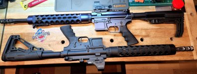

Wife and I shoot about 600 rounds a month for USPSA in PCC. I load 115g fmj on top of N340 getting 1150-1200 fps for minor power factor rules. Great accuracy, clean burning and 50y is not an issue. Of course this is not a self defense or a long range load. Rifles of choice are JP GMR-15s.
