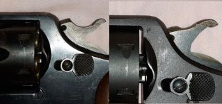

These are K frame revolvers, two long action (pre-war) above a short action (S-series post war). Cocked and fired.
The hammer spurs are different, but look at the firing pin nose to see the different lengths.
The postwar K-series Masterpiece revolvers have the short action. Other K-frame revolvers went to the short action around SN S990xxx, early 1948. N-frame revolvers went to the short action a little later, beginning around SN S78000, ca. 1950. I don't know the exact SN at which the N-frame change occurred, but certainly in the upper S7xxxx range. The hammer shape is a good indicator.
When did the action change on the "S" series post war M&P revolvers. This is my 1947 "S" and has the long action.:confused:
