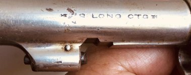

I just picked up this Model 03' in 32 Long 6" barrel.
It was in a thick and dirty paper sack at the bottom of a parts tool box that I won at auction. But that sack preserved it really well.
I've never owned one of these and have also never worked on one. Worked on many 38 M&P REVOLVERS. But this one has a unique action.
Serial number is in the 114,xxx range so likely about 1909?
Does anyone have a schematic drawing for this model? Anyone familiar with these early birds?

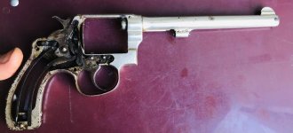

I haven't cleaned it up yet. I want to make sure there are no internal parts missing? See photos
The action is typical M&P but the double spring is off the hook. It seems to be binding in lieu of the rebounding spring that also serves as a hand and trigger spring but just want to make sure I'm not missing something or the gun may be missing a small part?
Can't wait to pop a few 32 longs through it!

".. also serves as a hand and trigger spring..." and cylinder stop spring. These are out of my wheelhouse, but identical to the workings of the 1st and 2nd Model Ladysmith's except they are a larger scale. I believe your revolver internals are complete and dirty.

Brush cleaned all the heavy scum off the inner frame etc and I actually found the binding issue.
This is why I really like having a schematic drawing of any gun I plan on disassembling and working on. Often there are very small parts that are broken, missing, or frozen.
An extremely small hook style pivot is located on the lower hand and it was frozen solid. (Photo 2) I freed it up and thank goodness it didn't fall off when I took the internals apart or I would never have found it or even known it was there or what it looked like or that it was even missing!
I think it hooks onto the tip of the return spring to provide a smooth operation of the hand but I'm not there yet. Still cleaning. The cylinder assembly is still soaking. It's got some heavy scum inside the chambers.
The return spring has a groove milled into the tip. That is likely where this little hook normally resides. Got lucky I guess.
