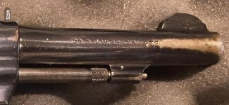

Have an inherited 1951 s&w 38 special ctg pre model 10 revolver.
Dave, this is what you need.
Are you talking .38 S&W Special or .38 S&W? They are different calibers.
The appropriate.38 Special for the time period would be 158 grain lead round nose. For .38 S&W it would be 148 grain lead round nose.
I was careful to post it correctly and took it right off the barrel.
Here is a pic.
.38 S&W Special ctg (cartridge)
The struggle I have is that the appreciated responses thus far would likely have me buying the wrong ammo all over again. Just being honest. Sorry.
I thought I bought exactly that but it turned out to be 38 special ammo which of course doesn’t fit.

.38 Special is .38 S & W Special, the factory developed the cartridge so they put their name on it.
Unless the gun has been altered or parts swapped, any .38 Special ammo should fit in your .38 Military & Police revolver. How do the ones you bought "not fit" - won't seat fully, won't insert at all, rattle in the chambers? Are the cylinder charge holes clean?
Again, please post a photo of the ammo you bought, the box and a round with a ruler near it?
If .38 Special won't fit your revolver, then either the barrel or the cylinder has been changed. Or, just possibly, the chambers of the cylinder are really crudded-up or corroded.
Are you SURE what you bought is labelled .38 Special? Or just .38 S&W? And how does it not fit? Won't go in the chamber at all? Or, goes in but not all the way?

I am trying to help, so please do not assume I am talking down to you as it is not my intention to do so, but 38 Special is the same as 38 S&W Special. Those two are absolutely interchangeable.
38 S&W, on the other hand, is not the same as 38 S&W Special and 38 Special.
The picture you posted appears to be a “standard barrel” as opposed to a heavy barrel used on the Pre-Model 10 or Model 10, also known as the Military and Police.
As others have said, the caliber marking on your barrel signifies your revolver can shoot 38 Special or 38 S&W Special, as those are interchangeable. If 38 Special will not fit in the charge holes of your clean cylinder, then it is possible an incorrect barrel was installed on your revolver chambered in 38 S&W, which is not the same as 38 Special.

I'm curious as well about what exactly you mean by "won't fit" ? Will they not go in the cylinder at all ? Too long ?
What exactly is wrong ?
A photo of the back of the cylinder might help. Also, let us know if the serial number on the back of the cylinder, bottom of the grip frame and bottom of the barrel match. there is a remote possibility the cylinder was sleeved to 32 S&W long, Highly unlikely but stranger things have happened.

If the OP's revolver won't accept SAAMI-spec .38 Special ammunition the most likely reason is chambers in serious need of cleaning and removal of accumulated carbon and leading deposits. Another possibility would be damaged chambers, such as rust or pitting from poor maintenance.
More remote possibilities might include a revolver with a non-standard cylinder installed (.38 S&W cylinder from another M&P or Victory Model in that chambering), or defective ammunition (such as reloads with improperly sized cases, seriously oversized bullets, deformed case mouths from improper crimping), or perhaps a damaged extractor star installed.
I would start with a thorough cleaning and inspection of the chambers. I have found several older revolvers that had never been properly cleaned, but responded nicely to simple bronze bore brush, good penetrating solvent, and normal maintenance procedures.
Beyond that, an experienced gunsmith is likely to identify any mechanical problems with a few minutes of inspection.
