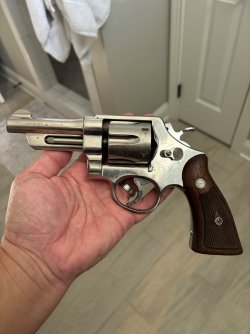

Serial S 141275
4” and appears to be factory nickel plated. It’s lived a life. I think it was someone’s carry piece. It had a bobbed hammer but I had a similar vintage nickeled hammer installed. It’s got wear and tear but it shoots great.
It was sold as a “S&W .38” with no reference to it being a Heavy Duty or N frame.
Thoughts on a value?

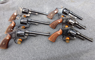

Here are my examples of pre, post and transitional Heavy Duties and Outdoorsman flavors. I've since found correct sharp shoulder stocks, and added another pre-war HD that letters as being shipped with a humpback hammer. The one in the pic doesn't letter with it.
