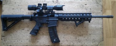

Here is mine....
Happy and safe shooting :cool:
