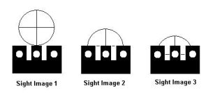

Using this picture as a reference:
When I shoot my M&P 22, I use the first sight picture. Line up the dots, or line up the top of the front sight to the top of the back sight, however you want to look at it.
When I shoot my 9mm Pro 5", I have to use the second sight picture, or actually even more pronounced than that. The front sight is way above the back sight when I'm hitting center mass. If I try to line up the front and back sights. I always shoot way low.
Since the rear sight is not adjustable for elevation, I'm not sure what else I can do except just aim differently with that gun. But it's frustrating because I'd rather have the same point of aim for each gun.

Sight Picture
Had a problem shooting low also. Found this somewhere on the forum not too long ago. Sight picture #3 was recommended for the 9c--working for me now although it takes come getting used to (as does any new firearm).

I think hstrawn is on the right track, with combat sights you should be centering the dot on the front sight on the center of the bullseye.
I have a pro series M&P 9L with a 115 target load from a bench my pistol printed a solid 4in low from a center mass hold. If you do a search you will see this is a pretty common issue with the pro series 9L. I solved most of my problem by finding a 147gr extreme plated bullet under a modest dose of AA#7 and it brought the impact to 1/2" under POA. This runs very good for me for steel challenge. If that will not do it, then take a trip to dawson precision for a lower front sight. To me there is only two acceptable sight pictures. And that is #1 & #2 from hstrawn's post.

Yes, many recommend #3, but they are wrong. Even so, it's not wrong enough to make a huge difference.
Curious as to why #3 is wrong. I'm new to my M&P 9c and looking for ideas/suggestions/opinions to try out in an attempt to improve its (my) performance. Also found this site from another 'sailor' -- supports the #3 picture but then looking at responses, individuality in technique rules.
Which is the correct one to use with an M&P?

We’ve been issuing out new guns to many of our guys recently due to life cycle limits. What I found out during this ‘reissuance’ is that due to a change in sight brand, the new guns shot POA/POI when using hold #3…or what was termed the ‘combat hold’.
The thinking is that when in a SD situation, if you look at your sights at all, it’s going to be a flash sight picture…putting that front dot on the BG is the easiest thing to do. For target shooting, it does take some getting used to for finer shots, since the sight tends to cover up those reference points.
I won’t get into my thoughts on this except that it’s doesn’t feel natural to me since I’m used to finding the top edge of my sight but maybe S&W is doing something similar.
