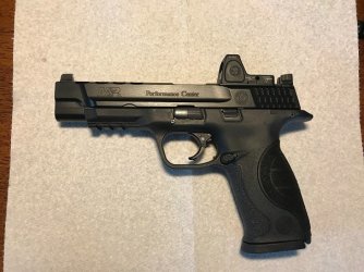

Just Mounted My Leupold
Hi,
Just mounted my Delta Point Pro 7.5 Triangle. Wish the Leupold Base was Thinner.
Going to Range Friday.
Thanks For Checking In.
