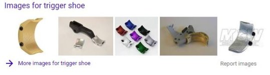

Apex sells triggers, not trigger shoes.
Yeah, I'm "that guy" who reacts to mixing up "trigger" and "trigger shoe" like other people react to mixing up "magazine" and "clip."
My bad, I always called it a trigger until someone "corrected" me. I took it for face value. I'll go back to my original lingo.
It IS a trigger shoe. that's a perfectly accepted industry term. A lot of places will sell a "trigger" that will include the trigger bar and/or other parts or they will sell just the "trigger shoe".
As for the polymer AEK trigger shoe... it does work with the 2.0. I have one installed on mine right now. as stated, there may be some tolerance issues on some guns that can cause this "dead trigger" thing that some have talked about. it happens when the built in over travel stop on the trigger shoe contacts the frame before the sear drops. the apex sear deactivates sooner than the stock sear so its not an issue. but if you want to use the stock sear with just the AEK you might have to just file down the over travel stop area on the back of the trigger shoe. Its just like the process that they describe for their SD replacement triggers. Just file the area until the striker drops and then go a little bit more to account for any expansion/contraction and you're good to go. you not have to do it at all. I filed mine down a little bit just because it didn't feel quite right. mine functions great... I like it a lot better than the hinged shoe... I can shoot a bit faster with the apex.
Highly respected sources like Wiley Clapp and the American Rifleman (NRA) would disagree - Terminology: Trigger Shoe.
I don't really care enough to read the link. All I care about is that the fact that people who make these parts will use the term trigger shoe so it's perfectly appropriate. You can call it whatever you want, just don't try to tell someone it's right or wrong based on opinion.
I'm all about learning and after a bit of looking, I agree a trigger shoe and trigger are two different things. Just as a seat and a seat cover are two different things...
Cool beans. Either term is used pretty frequently. Neither one is wrong in this case. It just makes it a little easier when talking about the parts when all the parts have a specific term. The term "trigger" is a bit too generic for me when discussing on forums because often times people refer to other parts of the trigger system as the the "trigger". I just chimed in on it because I don't like it when people try to assert their opinion as fact. That doesn't do anyone any good for the sake of learning.

A lot of us older 1911 guy's have carried over the nomenclature. The trigger "shoe" is the actual part you put your finger on (in a 1911), and the "trigger bow" is the part attached to the "shoe" that pushes on the sear (in a 1911). Nice thing is, we all know what you mean either way, and we don't put you down for it!
