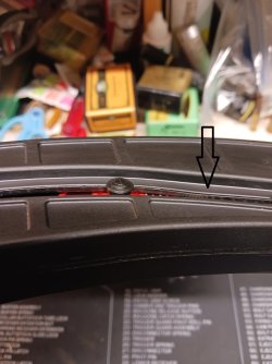

I have a new Ar-15-22 with 20 round mags. The follower binds and won’t feed properly. S&W supplied row new mags and I have the same issue

Yes MAGA jam even when empty Fowler gets tick half way
It sounds like the follower is hanging up.
With the magazine empty, try cycling the follower up and down a dozen or so times so as to maybe polish the track that it rides in. It may smooth out any burrs that are there.
