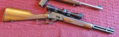

I have the factory sights on the 16" TALO 1894 I've owned for about 20 years. Were I interested in changing, I would strongly consider those Skinner aperture type sights. In any case, I've mounted a Leupold M8-4X compact scope on mine;)
colt_saa, That is neat!!!
