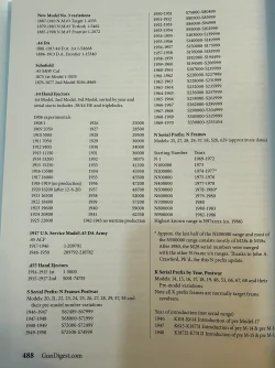

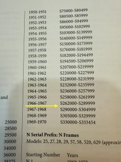

S268995 likely shipped in 1966. If it's a factory nickel 3.5" Model 27 in box you've got a nice one. The Model 28 Highway Patrolman is a good working man's gun but only a very very few were shipped in a nickel finish, and not in the time period of your gun. Please post a few pics if you can!
