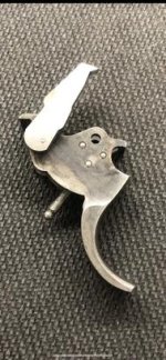

The other thing with this is, while it sports a wide target hammer, which may or may not be org. The trigger has been polished smooth...front, both sides and behind trigger curve, also narrowed? as its .265 wide. Could be a worked over service trigger?
While the while the trigger works great, very smooth, I am more of a purest, Hoping someone is looking for one of these triggers and I could swap it for a org smooth wide target....if that doesnt work out then maybe someone has one for sale.

That trigger started life as a standard .265" serrated service trigger. Serrations were polished off and trigger was reblued. Should be case colored.

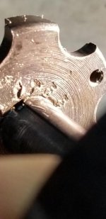

also the last 4 digits of sn 1755 is stamped under star, and cylinder takes a.22 mag rd

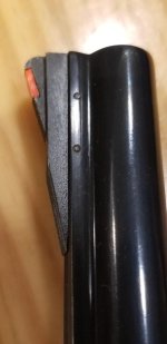

one other thing I didn't expect was the frt sight ramp is pinned on...my other models from same era ...different cals....the sight is machined into/ out of barrel...
thanks al

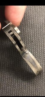

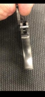

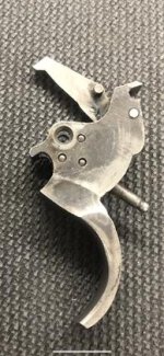

Trigger
I've got a wide smooth case colored trigger non mim I'd part with. Bought to put in a gun but traded it before I got it in the mail to swap it.
