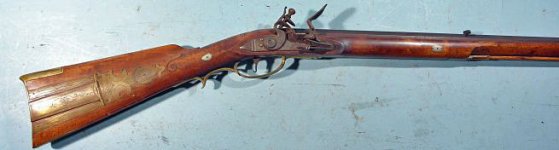

I am in the camp of cleaning brass and plate if you want to. It makes no difference either way as far as how I would value the piece. Your 1st Issue would be worth way more in your cleaned after condition than in the before condition for the majority of potential buyers. Silver plate was supposed to be polished, just like brass ornaments on muzzleloaders. I usually clean the brass on my flintlock rifles once or twice a year. I also polish the wood with Renaissance Wax, which does change the look and could also be construed as altering the gun's originality by some.
I picked this one up a few years ago and shoot it regularly. It was built by Leonard Meadows, from Beckley, WV, in 1969. He and Hacker Martin were well known gunmakers from the late 1950s through the 1960s. This was his heavy barrel target rifle and am sure it saw lots of use before I acquired it.
