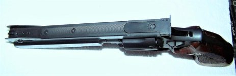

This revolver belongs to my Dad, and was given to him by the gentleman who had it built and competed with it in the 70's and 80's. The gentleman was a family friend and my grandfather's partner on the local PD. I've been doing a little research on it, and I'm curious if there is a definitive way to tell if it was actually built in the Bill Davis shop, or by another smith using Bill Davis parts?

With the markings on the barrel and rib I would assume (absent any additional info) that your gun was built by Bill Davis or at least in his shop. That's a fine example of the purpose built PPC revolver that would have been used in competition "back in the day". Congratulations.

I don't believe that Davis was selling barrels with his name on them — maybe it's possible. I would not suspect for any reason that what you show here isn't exactly what you think it is, a genuine Davis Custom. He nearly always added the ball detente lockup and it appears you have that, that's a feature that some builders did and many others didn't.
I'd definitely bet that is the real deal.

The rib was made by Aristocrat. It is the picture, but on the other side states Bill Davis.

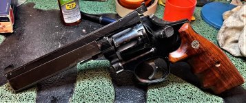

Here is one I acquired a few years ago. It was done by Master Gunsmith Ken Eversull using a Model 10-7 frame and a Bill Davis Custom Sight Rib. The barrel is slab sided and 6" in length. The gun's weight is approximately 3 lbs. 10 ounces.
I forgot to add: It is double action and the hammer has been bobbed, trigger has a an installed stop. and the trigger pull is 6 lbs.

The "Bill Davis" rib was indeed manufactured by Aristocrat, and was so-named because of his innovation of the sliding pre-set on the front sight, rather than the tri-set rear which Aristocrat had already developed; this created the "Bill Davis" model rib, which could be purchased by itself, and often was. Most, if not all, complete guns which came out of his shop were marked on the barrel. His guns came in several grades, with the "Windmaster" considered the ultimate, but slab-side and round barrels were part of his less expensive offerings. He even dabbled with .32 Long guns as an experiment, but major concerns were wind-bucking ability of the round, and a lack of speedloaders available. I had a good conversation with him about all this back when the NPRC was still in Des Moines.
