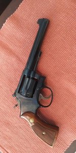

Hi All,
I inherited my dad's Model 14-1 8 3/8" SN K4704xx. SAO, but I always wondered if this was from the factory or a modification? Pulling the trigger rotates the cylinder with a slight hammer retraction. Shoots like butter. I shot it recently and had a lot of trouble opening the cylinder. It seems like the front of the ejector rod is hanging up on the plunger but everything else seems to be working properly. Any ideas? I took Glock and M-16 armorer courses (for work) and I'm pretty good with tools but I'm far from a gunsmith, and no experience with revolvers.
Thanks
Sounds that the ejector rod may be slightly unscrewed. Remove the cylinder, put some fired cases in it to hold the ejector star in place and gently tighten the rod. Look for instructions on youtube.
Yes, there were model 14s SAO. S&W sold factory parts kits for that and may also have assembled some like this from factory. They are famed great shooters. I do not have one, wish I had.
Others more knowledgeable may know more.
Also you may want to do a search here for "14 SAO" - there are many threads discussing them. One for example is this:
http://smith-wessonforum.com/s-w-revolvers-1961-1980/648828-model-14-single-action-only.html?648828=#post141132347
Awesome and thank you all. I did notice that the ejector rod spun so I tried it a little this way and that but didn't want to mess with it too much. Spun it left hand and it retracted a good 1/8" and now is fine. I know there were kits for SAO but was wondering if there was a way to tell factory from parts kits, or if that even matters. I'll do some homework. And I was incorrect, the hammer drops a little when the trigger is pulled to rotate the cylinder - I had said it retracts a bit.
