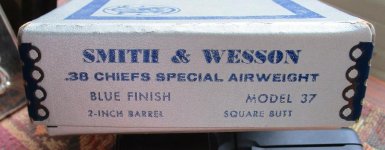

I dug around and came up with this box. Is it correct for the 1952 Combat Masterpiece? The end label is for a 38 not a 22. Guess I would need a label for a 22 caliber. My revolver does have a Target Hammer.
