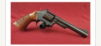

I have a dash 2 and a dash 3, both in 6". The dash 3 has a patridge front sight while the dash 2 has a rectangular front sight.
What other changes are there between the two and which is more desirable? Both are great shooters.

No significant engineering changes between the M19-2 and -3. The dash 2 still has the diamond stocks, (they ended on all guns ca. 1968). The rear sight leaf screw was moved on the -3, and the later half of dash-3 production have the gas ring as part of the yoke, it was moved there from the cylinder, without an engineering change; it was moved back to the cylinder when the dash-4 was released.
Front sights were an option and both the -2 and -3 could have either the Bauman ramp or the Patridge, but usually the Patridge is only seen on the 6" barrels.
Either dash number is a desirable gun, IMO older is better as a collectible. I have a dash-3 from 1974.
Sights were optional - Patridge or Baughman. This has nothing to do with the -2 to -3 change.
The real difference between the two is the -2 has the rear sight leaf screw located directly above the barrel/cylinder gap. On the -3 it was moved forward, away from the gap.
