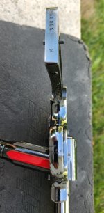

Last week at a local online auction, I won a 1959 model 19. Serial # K356856. Due to the auction house schedule, I can't pick it up until after next week. I will post photos at that time. The gun is blue and has some corrosion issues. My question is. Can the whole gun be submersed in the lubricant mixture without detriment? Of course, the stocks would be removed first. The gun appears to be in pretty good shape. I am not comfortable with removing the side plate. I do have an air compressor to blow it out after soaking.

Model 19, four screw variant. Picked it up today.
Here are some photos of the package. Revolver, box bottom halves, papers, and holster. Gun pictures to illustrate pre-preservation condition.

I think you will need some bronze wool and oil to remove that rust. The soaking in the ATF / mineral spirits won't affect that at all.
