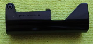

This 25 ND came to me with this Smith & Wesson Muzzle Brake. Not what would go in your empty slot, but an interesting and scarce piece. KenL has one for a K38 but this is the first one I've seen for a 45 ACP.
