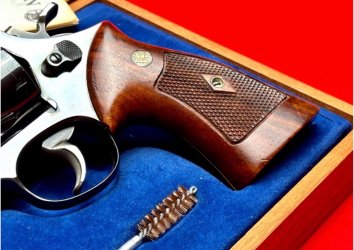

Hello Tomdrpm, I was just going through some of these old posts regarding 29-2 stocks. My ‘S’ prefix 29-2 is very, very close to your serial # - in fact I’d suggest manufactured same day. Unfortunately the pics you posted are no longer visible, and I am intrigued to see if our stocks are the same. (I have attached a pic), as you can see they have the diamond, but no ‘cut-out’ on the left side. The pistol is in beautiful unmolested condition, in it’s original case with all paperwork, tools, wrapping paper etc, so I have assumed stocks are correct, and after researching it appears that S&W did make stocks without the cut out on early 29’s. Love to get clarity. Cheers.

Gomer1...The correct stocks for your 29-2 (assuming it was shipped in 64-65) would be special oversize stocks made of Goncalo alves or "coke bottle" stocks. The stocks have a larger area of checkering and a relieved area on the left stock panel. The stocks currently on your 29-2 were introduced in the early 1950s and used through 56-58.

Thanks Bill, appreciate your response. Yes, my research would indicate it was shipped 64-65. Like many, I am a sucker for 'correctness' and originality, so I guess the question now is, are these older stocks rare or of value if I choose to go on the unenviable hunt for a sensibly priced set of correct stocks (either GA or CB) - or a long shot, maybe find someone who has the later correct 29-2 stocks on an earlier 29 looking to swap. Thanks
Rare or of value is dependent on your thinking.
Of value yes absolutely
As much as cokes no
Yours would range in the 250 +
Cokes more....how much more depends on the set and your hunting skills
