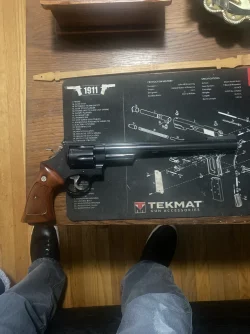

I have a model 29 -3 silhouette thinking about changing the barrel to a 6 inch non pinned thoughts sorry new to this don’t know how to change title 29-3 is correct
Yea I found the barrel but you might be right M29 talk to one gunsmith entails quite a bit of work
If your Silhouette model is original and in nice shape I’d be surprised if you couldn’t get a fair price for it. 6-inch guns are much more common.
The 29-3 silhouette is a fine gun, I had 2 of them and they are good shooters.
Keep it or sell it, but leave it as is, and buy what you're hankerin' for instead ;)
Having seen my gunsmith working on a S&W rebarrel job, it can go from a perfect match with little fitting.
Or it can be a huge job needing to machine back the whole shoulder/ejector rod cover (for clearance), threading back the new barrel, re-cutting the forcing cone, resetting cylnder gap. Kinda of a gamble.
He said it’d be easier to mount a custom barrel.
