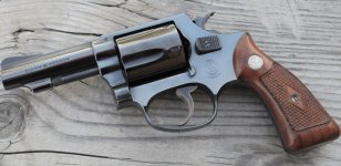

I have what I think is a model 36 that is double action only with a great trigger easy pull and smooth
I have the original matching ser# wood grips with the diamond
love the gun and it is my first revolver
why is it double action only ?
specs below
ser# 1010xx
flat latch
1-7/8" barrel
5 shot
round butt ---- how we all like them right
pics below

It's a Chief's Special, forerunner of the Model 36 -- just a 36 before they started putting model numbers on them. If it's truly DA only, it's because the single-action hammer notch is gone, either worn, broken or intentionally filed off by a previous owner to make it DA only.

Google "picture S&W single action hammer notch". You'll quickly find a picture. Note, the notch is very shallow to begin with. As noted, it can break, and it can easily be filed away or unintentionally rendered useless by an unknowledgeable person seeking to "improve" the single action trigger pull.

The company probably shipped your Chiefs Special in late 1957.
It has a 3-screw frame (one screw is hiding under those ugly galoshes on the right side -- no slam at you, I simply don't like rubber grips). It would have come with diamond magna stocks (like the first photo, below).
As an aside, some of us like square butts and 3" barrels better. :D

looks like the single action notch was never there smoothly gone both trigger an hammer when cocked line up near perfectly even almost like it was sent that way
nice work who ever did it
I thought about bobbing the hammer since it isn't single action but not sure

If you aren't going to restore full SA/DA capability, I'd leave the spur alone. Looks better and has the hammer mass to detonate a hard primer.
Some holsters also fasten behind the hammer spur to make the gun more retainable under strenuous activity.
