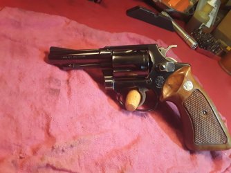

Apologies to all if this is inappropriate, but I too have a 36 no dash, 3" tapered bbl, square butt with stocks larger than the OP's, almost like "cokes, with medallion. Very nice original unmolested condition. I would appreciation any help dating this gun, Ser. No.90J692. Thanks, and again, not my intent to high jack this thread.
Thank you, Bob. So good to know who and where the expert advice will be found. I know the image isn't the greatest but would you have a ballpark value for this gun? I finally was able to post the pic, but the next time I tried (another thread, Mod 19 no dash in very similar condition, I could not make it work.)
Thanks again for the very prompt and courteous assistance!

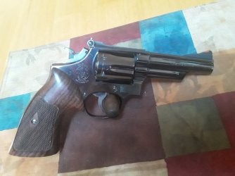

Trial pic posting: As mentioned above I'm still trying to get the hang of posting pics. Success! Below is the Mod 19 referenced. Ser. No. K421093
Appreciate your indulgence!
