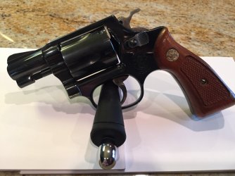

I have this square butt Model 36 with an "ACH" prefix which dates to 1983…
(Need to take some better photos…)

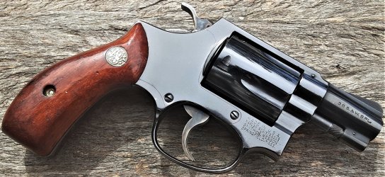

Here is a picture of one of mine. Model 36 from 1964; square butt, 2" barrel.

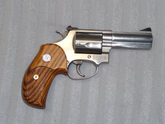

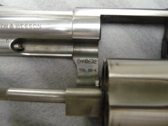

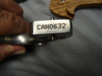

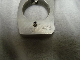

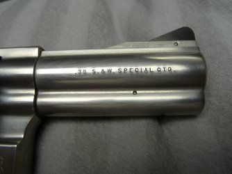

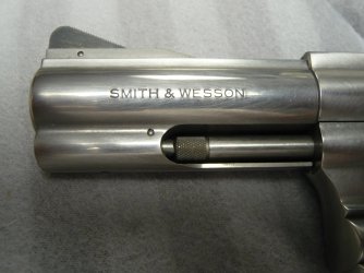

Some photos for your analysis: P.S. I would like some input on my Pre 18 Combat Masterpiece, I'll open a new thread with a number of photos. I'll title the thread "Questions on Pre 18 CM".
P.S. I forgot to ask...what is 'oddball' about it? BTW, I have like 4 sets of stocks for the J frame, the originals were black rubber as I recall.
Ah, ha, a Model 60-4 Target model. Nothing at all oddball about it. (The serial ranges I mentioned are the oddballs.) Yours likely shipped in 1995/96. Later in 1996 Smith & Wesson replaced the Model 60-4 with the Model 60-10, built on the company's new J-magnum frame and chambered in .357 Magnum.
Yes, the original Model 60-4 grips are Uncle Mike's Combat grips.

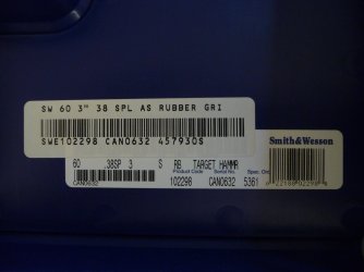

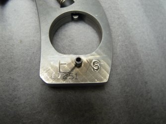

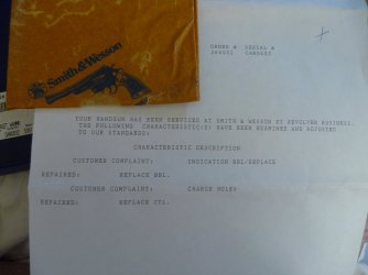

I had forgotten, but as you can see on the return paperwork, I had sent it back to Smith for a (?) barrel and cylinder 'problem' and they replaced both. I assume some of the grip frame markings indicate that 'repair'. The photo of the box labels are now under the foam on the inside of the lid. I don't remember doing that, maybe Smith did when they serviced it(?). The label indicates it has a 'Target Hammer'. So, you are saying there is nothing of 'note' on this gun as far as rarity or desirability, if I'm understanding your response. Yes, I do have the original Uncle Mikes combat grips, they are currently residing on my 637-2.
P.S. Is there any significance to the 5361 on the label under 'Spec. Ord.'?
No, I didn't suggest the Model 60-4 isn't desirable. It's a coveted model among Chiefs fans, I believe primarily due to its target sights, and it's the last Model 60 to use forged steel parts for the hammer, trigger, and thumbpiece. Subsequent models have metal injection molded parts.
The first two Model 60s with 3" Heavy Barrels are simply less common. Smith & Wesson produced parts for the 3" Heavy Barrel Model 60-1 with a square butt in 1972 then assembled and shipped 169 of them to multiple distributors on June 12, 1978. Then in 1984 the company made 1,000 Model 60s with 3" Heavy Barrels and square butts for John Jovino Company in New York City.
I don't know production numbers for the Model 60-4 (1990-1996), but we sure see lots more of them than the first two.
