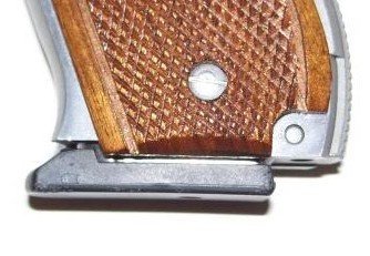

Several moments later, I was awarded with a workable 9-shot magazine that fits flush with the bottom of the gun (albeit the polymer floor plate extends .010" past the mag well opening.
A function test with dummy rounds and the obligatory last shot slide lockback worked. I tested this onto the original 1970s-vintage blued 39-2 magazines. All of them worked perfectly. An added bonus is that the front of the new-style baseplate affords the gunner with a way to strip the magazine in the unlikely event of a double-feed.
