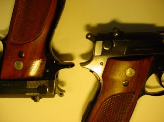

the 39 on the right is all steel. notice the difference in the tangs. the all steel tang is sharp at the tip. the alloy 39 is rounded. there is also a difference in the color of the frames. serial numbers will not confirm all steel or not.

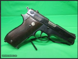

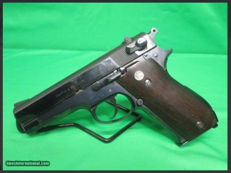

For me, the dead giveaway was the shortened tang. Recently there was a 39 advertised on guns.com and priced like an alloy 39 with no mention of it being a steel frame. But the short tang was evident. The serial number was in the range of a steel framed 39 as well. After checking with cougar015 I purchased the gun. Let's say I got a steal on a steel framed 39…IMG_4908.jpegIMG_4907.jpeg
