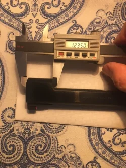

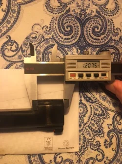

I recently got a 5.5" barrel and discovered it needed more than basic fitting work.
I'm new to the forum, so it's likely that this has already been discussed.
The slide was unable to close completely.
Why?
The slide was hitting the right-side barrel relief towards the front, although the slide worked perfectly with the 7" barrel.
As seen below, the 5.5" barrel reliefs were not machined identically .... the left and right sides differed by over 0.025".
That's pretty sloppy.
The pics show the measured disparity, as well as the obvious distortion to the right side barrel relief from whatever gun this use to be part of.
The radius of the relief in the region shown corresponds well to a 3/8" dia endmill, so ..... a little work on the mill (shown) brought both the left and right barrel reliefs to within a few thousandths of each other.
All together again and NOW it shoots perfectly.
Is this sort of thing normal or expected?

Not surprised that fitting was needed, but this is the first case I've heard of this place needing it.
I had an early 1990's vintage 41, bought new that showed the same peening as your pic. It operated perfectly however, in fact it was the most reliable 41 I've ever had. It ate anything I fed it, including thousands of rounds of high velocity bulk ammo so I never tried to "fix" it. I chalked it up to the high velocity ammo causing the deformation but after reading your post maybe it was crooked from the factory?

Some complaints about issues with S&W quality control that I see are not too serious, although it certainly isn’t the golden age for craftsmanship there. This however seems to me to be a serious fail. I am glad you had the skills to do such a nice job cleaning up an issue that should never have happened. No surprise that the model 41 is being retired if this is any indication of the care taken to look a gun over before shipping.

Looks like some of you have also seen this. Glad to hear that, … I’d hate to think I milled the thing for no good reason, like maybe this is normal and there was some super simple well known fix.
I can exhale now 🙂
