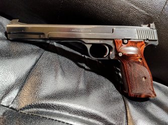

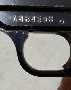

My 7" which I think is a 77-78 vintage by the serial number of A484398.
Also has a set of Altamount (I think) aftermarket grips, which feels very good.
