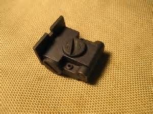

4 .45Gunguy Joined Aug 9, 2025 Messages 2 Reaction score 0 Today at 10:58 AM #1 I am trying to find what year my model 41 Smith is serial # no prefix no suffix 97xx. I need a rear sight for that year. Any help would be appreciated.
sceva Member Bronze Supporter Joined Feb 19, 2004 Messages 2,276 Reaction score 3,666 Location NE IL but I'm from Ohio Today at 11:44 AM #2 Below may help but it's incomplete Checked the SWCA site and Model 41 S/N 9812 shipped in May 1958; so 97xx would be late 1957 - early 1958 Assuming it is a 7 1/2" barrel the rear sight was the same up to the 1990's I believe and they often come up on ebay A 5" used a model 52 type rear sight Sight for 7 1/2" Sight for 5 inch Summary of S&W M41 Dates of Manufacture Gents, Here is a Summary of S&W M41 Dates of Manufacture from this Thread: Serial #___ Date of Mfg. 104XX_______ 1958 149XX_______ 1959 189XX_______ 1959 295XX_______ 1960 1120XX______ 1969 114XXX____ ~ 1969 "A" Prefix_____ 1970 with A115001 A145801_____ 1972 A225XXX_____ 1973 A235001_____ 1974 A265001_____ 1975 A295001_____ 1976 A414XXX_____ 1977 A475001_____ 1978 A5824XX_____ 1979 A5841XX_____ 1979 A7175XX_____ 1981 A7981XX_____ 1982 ADB38XX_____ 1983 A875000_____ 1984 TAA1985_____ 1985 TAK7879_____ 1986 TAT2512_____ 1987 TBL7955_____ 1988 TFJ1141_____ 1989 TFNxxxx_____ 1990 TFRxxxx_____ 1991 THD23XX_____ 1991 TZUxxxx_____ 1993 VAMxxxx_____ 1994 S&W started D&T M41 brls in 1994 UAMxxxx_____ 1997 BMC29XX___ > 1998. The above courtesy of Standard Catalog of Smith & Wesson, 2nd Ed. by Jim Supica and Richard Nahas.
