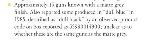

You are probably familiar with the 'rare' matte fixed sight 559s that were made in 1985. There was a thread on one 'recently' but I can't seem to find it.
The SCS&W makes mention of them and states about 15 were made.
