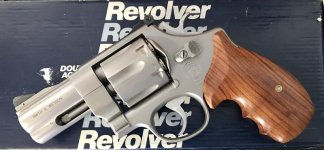

I have a 625-6 with a 5" barrel that I bought new in 2001. I bought it to shoot cast bullets. Without examining the gun, I have no idea if it's pre-lock, lock, or somewhere in between. Same for the parts. If it has powdered metal parts, they are so close to forged steel, I can't tell the difference. The gun is quite accurate. Same for the 625-3 3" gun I bought new in 1992. If it's all forged steel, everything seems to work as well as a gun with powdered metal parts. It's accurate, too.
