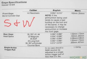

Many things could be causing this. Most likely run out on the extractor rod, a misfit or improperly fit interface between the front locking bolt and the end of the extractor rod, excessive end shake, misalignment of the yoke barrel, or barrel extension and cylinder face binding at the B/C gap.
Yoke barrel misalignment causes the center pin to bind in the center pin cavity in the breechface. Excessive end shake (over .002") can cause the cylinder to move forward in the assembly, and bind on the front locking bolt. The barrel cylinder gap should be around .004".
