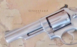

:cool:As others have stated the stainless rear target sight faded out by 1975, It is unique to the early Model 66 and 67.
On a side note:
I've never seen a 66 snub or a 6" with a raw stainless rear site, it should be noted that the Model 66/67 went to a Blackened Stainless rear site, If you remove a black rear site leaf on a 66, 66-1 or 67/67-1 you should find the letter "S" stamped underneath indicating it is blackened SS.
Another thing is that reportedly many PD armorers were sent replacement Black rear leafs to be swapped out after complaints of difficult visibility so don't be surprised if you find a pre 75 version with a black rear site.
I have examples of both a 66 and a 67 with stainless sights.
