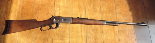

Oops! I forgot I had a pre-64; this one is really old and was rebarreled to .25-35. It hits to point of aim at 400 yards; flat shooting as can be!
There. Everyone likes pictures. My Angle Eject .44 Magnum was sold, as was my Trapper model and all of the others; just found myself going in other directions.

I stand corrected :
I was thinking of the Model 94 ANTIQUE.
