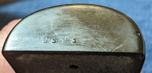

I just purchased of Model of 91 that needs some work. Don't have it in hand yet so these are the only pictures I have. The frame and the barrel assembly serial numbers don't match. Bought it for parts since it needs some work.
Just looked up the serial numbers for single shots in the book Smith and Wesson 1857 - 1945 by Neal and Jinks. Neither serial number was listed in the 22 or 32 caliber section but it was listed in the 38 caliber Single Shot section. The frame is listed as one of 8 with and SC next to it. The book says its a Sample Combination set frame.
Never noticed before that they made sample sets. Does anyone know what they were or what they included? Do complete sample sets still exist? For some strange reason this frame has the serial number stamped on the back strap above the grip. This one will defiantly get a letter. Will also need to raid my stash of spare parts to put it back to a better state.
Serial number?
I can’t comment on sample sets but I can comment on that number stamped high on the back strap. That wasn’t done by the factory in my opinion that’s an agency number. Or property number. Those numbers are not Smith & Wesson die stamps. They are plain block numbers.
I’d bet there is a serial number on the bottom of the grip frame. A 4 digit serial number is too low for a frame having a logo stamped on it. Post 1896.
I also don’t believe those Target grips came with this SA MODEL OF 91. They were added some time later. A factory stamped serial number on the bottom of the grip frame would be proof it came with standard size grips originally.
Murph
I have never seen the serial numbers on the back strap like on this gun. There is not a serial number on the front strap like they usually stamped on single shots with target grips. There may be one letter or number on the bottom of the frame, I can't tell from the pictures. There are no serial numbers on either side of the frame under the grips.
Was the Model of 91 the first gun to have the grips cover the bottom of the gun, in the target configuration? According to book Smith and Wesson 1857 - 1945 the 38 S&W was the first single shot barrel and gun, with a 6" barrel. It says shortly after the 32 S&W single shot barrels were available. Then not long after the 22 caliber barrel was also available.
If its a true sample I guess I don't need to send in for a letter. Its states in the same book where those 8 sets were shipped to/assigned to.

The Model 1891 was the first single shot pistol made by S&W. There were 22, 32 S&W, and 38 S&W barrels, all interchangeable. Photos of the butt and frame numbers along with anything on the bottom of the barrel would be helpful. You might be confused by the fact that the frame of these single shot pistols were actually from the 38 Single Action revolver. I have a 38 Model 1891 target revolver with a 38 S&W barrel as shown in a put together kit that I did years ago. These were called combination sets.

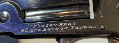

There is another marking on the frame, from the british importer: "Watson bros", who still exists today and seem to have keep records back to 1875 according to their website, so that's another string to pull to know more about the history of this gun ^^.
I will keep you updated, thanks again!
