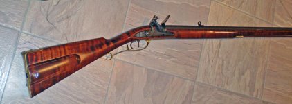

The main concern for me when using rust bluing is the amount of time you leave the solution on the metal in a tented environment. It is quite easy to get heavy pitting and it is better to err on the side of shorter rusting time when using a tent. More cycles of shorter duration should give you the smoothest finish.
I have built muzzle loaders and always desire a heavy brown to give the metal parts a proper look of a 1700's era finish. Parts are finished with a 320 grit before browning. Leaving parts in a humidity tent for earound 10 hours at a time will impart a really rough finish after about 6 cycles. I do not boil the parts for the effect in the pictures below, but the finish is quite dark and appropriate for this era rifle.
